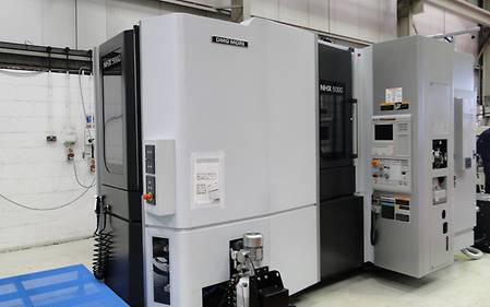

NHX 5000 at Rolla-V

Previously the company produced the Rolla-V and special tooling on pre-owned vertical machining centres but, with 75% export and projected growth which is expected to double turnover by 2016, this method of manufacture was unsustainable. Chris Lawlor, General Manager at Rolla-V, says, “We have already invested a new Blohm grinding machine, so the next stage was to increase the productivity of the machining operations.”  Working with DMG MORI, Rolla-V selected the NHX 5000 horizontal machining centre with twin pallets. By using tombstone fixtures, the company will be able to load up to eight parts on each fixture and hence cut 16 parts every night with unattended operation. Chris Lawlor adds, “With vertical machining, we get a build-up of swarf and associated problems with broken tools. Horizontal machining will solve both of these problems. Additionally, we have Renishaw probes for in process checking of the part geometry and tool breakage detection to avoid any problems during out of hours working. To cope with some of the larger fixtures, we have also had the table uprated to 700kg to allow us to make more parts as demand grows.”
Rolla-V
NHX 5000 plus operator at Rolla-V
Horizontal machining offers further advantages in the accuracy of positioning of the parts in the fixture. With vertical machining, swarf can be inadvertently trapped under the component, leading to scrapped parts and inaccuracy. With the NHX 5000, not only does it have hydraulic clamping, which gives a much more repeatable result, but swarf will also naturally drop away from the fixture. Furthermore, the Renishaw probe will check the position of each part and feed any discrepancy back to the machine control, automatically offsetting the toolpath to match the actual position of the component.
