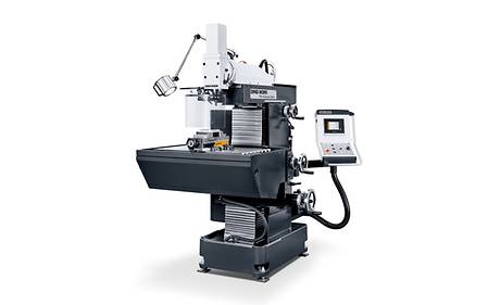

FP 4 M Special Edition
The Conventional Milling Machine for Training and Manufacturing
 FP 4 M by DMG MORI
  • Tried-and-tested concept with over 10,000 installations
  • Maximum precision and stability
  • Customised to meet specific training requirements
  • Small footprint – integrated switch cabinet means minimum space requirement
  • Ergonomic handwheel positioning for maximum operating comfort
Technical Specifications
Workspace (X/Y/Z)
500 / 400 / 400 mm
Rigid fixed tableclamping 800 x 480 mm
Spindle drive25 – 3,000 rpm infinitely variable with data input at counter
Regulated AC drive6 – 7 kW
Vertical headswivel-mounted head +/- 90° (180°)
Linear axesfeed range 6-500 mm/min
Rapid traverse1,500 mm/min
Space requirement
approx. 2,235 x 1,875 mm
Machine weight
approx. 1,600 kg with table and milling head
Control
  • Heidenhain digital display ND7013
A classic is back! DMG MORI’s state-of-the-art design coupled with timeless and top all-round performance makes the FP 4 M Special Edition the ideal milling machine for manufacturing and training.
