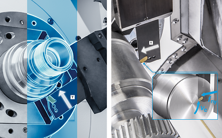

Y-Axis Parting
  • Higher stability due to optimal force transmission in thelongitudinal direction of the tool holder
  • Generation of tool feed in the Y-direction for parting off components at a push of a button
  • Compatible with the standard cycle CYCLE92 (Part off cycle), so that the operator can program as usual (ShopTurn and DIN / ISO)
Customer Benefits
  • Up to three times higher productivity possible (3x feed) with simultaneously improved chip control
  • Reduced noise level and higher surface quality through more tool stability
  • Less material loss due to reduction of the parting width
User Interface
Left : Operator mask for switching on the Y-axis parting cycle on turret and turn-mill machines. / Right : CoroCut® QD for Y-axis parting cutting tool technology developed by Sandvik Coromant.
