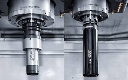

Maintenance Package i4.0
Alternating speed
  • Automatic recognition of tool pull-in force for consistently high process stability.
  • Predefined cycle for automatic lubrication, every 75h or after 20,000 tool changes.
  • Detection of leakage and measuring of usage of pneumatics system.
Customer Benefits
  • Efficient and timesaving lubrication without operator intervention
  • High transparency by displaying the lubrication cycles and the current pull-in force.
  • Data recording in combination with the optionally available Condition Analyzer for additional analyzes of air consumption and changes of the pull-in force
